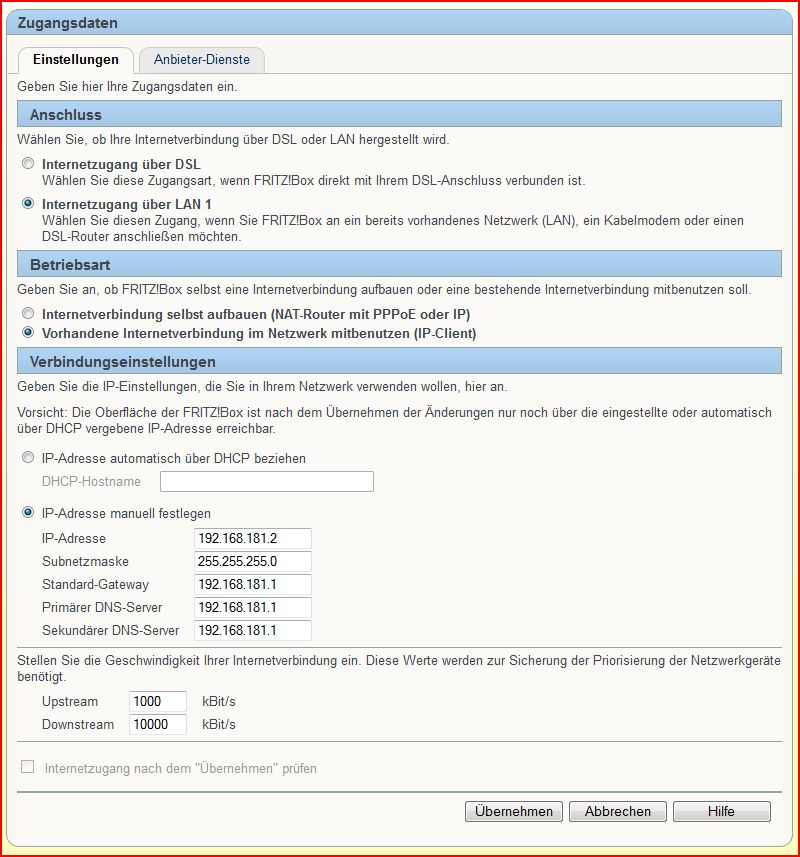

BeitragVerfasst: Mo 14. Jan 2013, 12:20
Beiträge: 979
1. Check internal IP-Adress of your cable Fritzbox (i.e. 192.168.178.1) and write it on a paper.
2. disconnect LAN cable from PC to cable Fritzbox, connect LAN cable from PC to 7170 (your 7170 is not connected to cable)
3. turn 7170 on and wait until it finnished booting. You will see some blinking lamps (no connection to internet) but this doesn't matter
4. usually you should have connection to http://fritz.box - if not, just reboot your PC
5. make settings like my example in attachement. Please change IP to your envirement. After you pushed "übernehmen" you will not see any response from 7170. This is ok.
6. disconnect PC from 7170 and connect 7170 to your cable Fritzbox. You MUST use port 1 on 7170.
7. connect PC to cable lan (like before).
Now you should
- have conection to internet again
- have connection to Fritz.box as before
- have connection to 7170 via ip-adress
you just have to setup your voip
7170-zugangsdaten.JPG [ 129.05 KiB | 6405-mal betrachtet ]

BeitragVerfasst: Di 15. Jan 2013, 07:24
Beiträge: 979
Configuration I discribed above has to be done without any connection to 6340/6360.
Connect your 7170 with correct LAN port to 6340/6360 after configuration.
If your configuration was correct your 7170 ist available at http:\\Ip-Adress of 7170.

BeitragVerfasst: Di 15. Jan 2013, 12:36
Beiträge: 979
You should be able to connect to 7170 via emergency IP (http://169.254.1.1)
Please make sure that only Notebook is connected to 7170.
Within user interface expert mode should be enabled. (You see it top right on start page)
Now go back to the page I published above. and check settings again.
Wherever I set 192.168.181.1 you have to set IP of your 6360
Where I set 192.168.181.2 you have to set IP of your 6360 but last digit is 2.
Subnet mask 255.255.255.0 is correct.
Push accept button.
Now connect 7170 Port1 to any Port of 6360.
Either you just reboot your notebook or went to the desktop PC.
You should now be able to access 7170 via it's ip-adress. (http://ip-adress-of-7170)

BeitragVerfasst: Di 15. Jan 2013, 15:58
Beiträge: 979
I found a unused 7170 at home and made some tests:
Please connect LAN cable on 7170 not to port 1. Please use port 2-4.
Turn off WLAN if used. (in Notebook and 7170)
Restart Notebook.
Check IP adress of your Notebook in your envirement above. (Either Network Center - Lan - Details or cmd.exe ipconfig)
If your IP is 169.... http://169.254.1.1 should work
if your IP is 192.x.x.x http://192.x.x.1 should work
Port1 on 7170 is used later on to connect 7170 to new 6360 Network as client.
