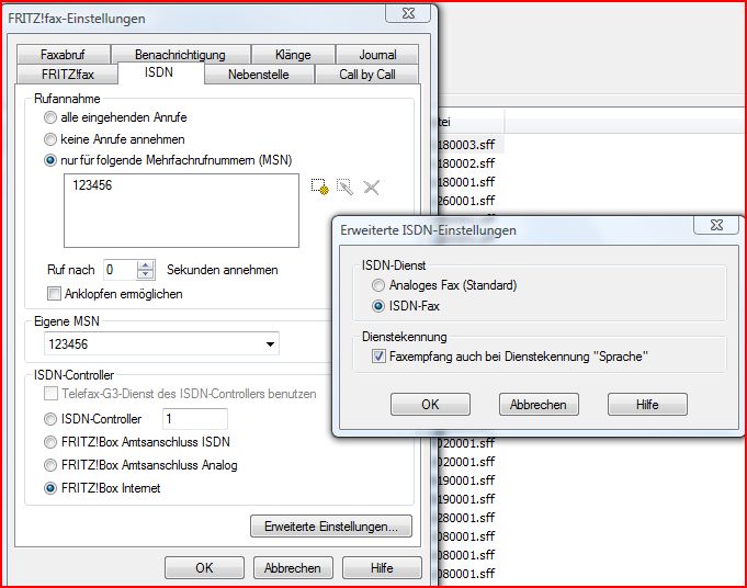

BeitragVerfasst: Fr 18. Jan 2013, 14:51
Beiträge: 979
This morning I spent some time in several tests.
In my mind best practice for incoming and outgoing fax with 1 line is as follows:
(Please remember, we are talking about very less incoming fax)
Install Fritz!Fax (while installing procedure take care to disable any firewall on your pc)
After install Fritz!Fax should start without any error messages.
If you get some messages only push ok button. (maybe several times).
Now you should open fax - settings - ISDN and check my settings.
Your local phone has to be replace my "123456" (my number is only fake)
If you got some error messages before, I guess radio button "Fritzbox Internet" is greyed and not pushable.
In this case you have to close setup window (better fritz!fax too) and to call #96*3* to enable capiovertcp (http://service.avm.de/support/de/skb/FR ... rtet-nicht only availible in german)
Now this should work correct. Otherwise I give you another link.
I aktivated in enhanced settings speech too.
In my envirement I got this:
If Fritz!Fax ist opened, I get Fax inbound and Fax outbound but no phone.
If Fritz!Fax is closed, phone is active.
If you disable dialin in Fritzfax, phone inboundt and fax outbound will work.
Disadvantage in this scenario: Fax sender has to anounce fax before via phone.
fritzfax.JPG [ 76.2 KiB | 5350-mal betrachtet ]

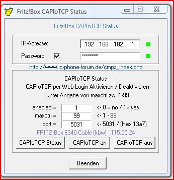

BeitragVerfasst: Mo 21. Jan 2013, 23:33
Beiträge: 979
Did you tried AVM variant?
1. give your Fritzbox a password (if not already done)
2. make sure your Fritzbox desktop is in enhanced mode
You will find both points in menu "System"
3. install a simple analogue phone on Fritzbox (if not already done)
4. call #96*3* with this phone and wait about 15 sec. (until you hear busy signal).
5. Login to your PC with administrator privileges .
6. Start Fritz!Fax and Check "fax over internet"
7. If its still grey reboot your pc and check again.
8. If there was no effekt
9. register on http://www.ip-phone-forum.de/ (without registration no download)
10. Download Fritz!Box_CAPIoTCP_Status_2108.zip at http://www.ip-phone-forum.de/showthread ... ost1874421
11. extract file whereever you want
12. run Fritz!Box_CAPIoTCP_Status.exe / enter password /click "CAPIoTCP status"
13. if enabled = "0" click "CAPIoTCP an" few seconds later enabled should be "1"
14. maxctrl should be < 1 (this is text field)
15. port should be 5031 (no change)
Before you go to points 6 to 8 please make a small coffee break or just wait 1 minute.
No more info available in "blind mode" :cool:
